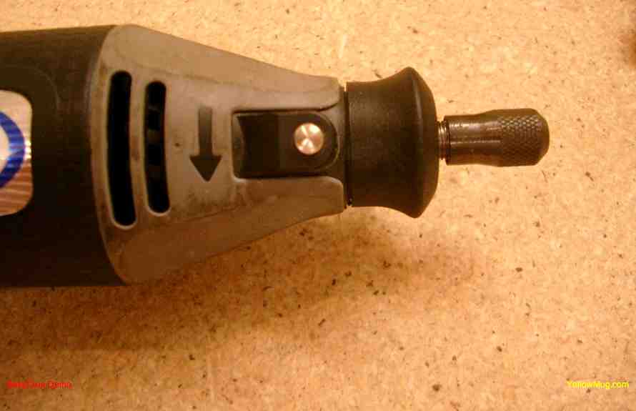

Also, I have a Dremel now, but it's a different Model. It's an older type, variable speed w/ push-buttons. I'm not sure if it's capable of mounting to their router base. There are no threads on it for screwing into something. Would I be better off just getting the newer Dremel 400XPR that's just one set speed, & know it will mount up to everything w/o any problems:
My Dremel: (excuse the pic, batteries are dying)

Rich the Dremel in your photo appears to have the screw on collett required to fit into the Stewmac router attachment.
Can you post a close up pic of the front end of the tool?
Cheers Martin

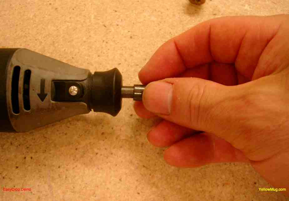

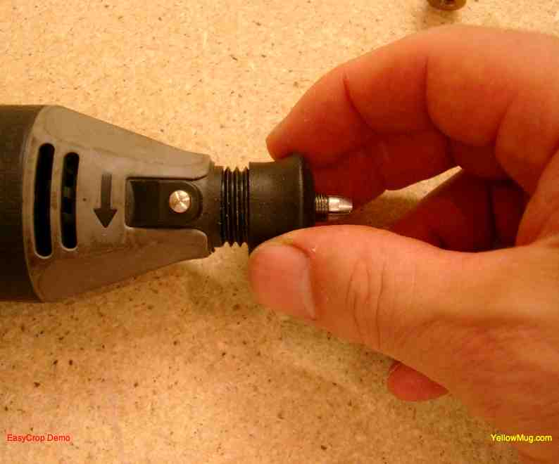

Rich,
See pics below of my Dremel being fitted to Stewmac router attachment.
Cheers Martin

Great Pics ~~ Thanks! Looking at mine, it would thread. But, it's as Michael said, "it has really poor bearings." Plus, it's been used extensively for years, compounding the problem.
